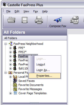

5. Right-click on the FaxPress Premier server and select Properties.
6. The FaxPress Premier Server Properties window will appear, with the Server Settings tab selected. Use the Server field to rename the FaxPress Premier from the default serial number displayed on the Premier’s LCD panel. The grayed out fields are provided for backward compatibility with FaxPress servers, and are not editable in Premier.

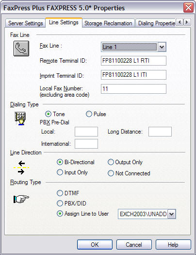

7. Select the Line Settings tab. The Line Settings options provide information the FaxPress needs to communicate with other fax machines. The number of fax lines the FaxPress Premier has will depend on the model. Each of the Premier’s fax lines is inde-pendent and operates concurrently with the other fax lines. Using the Fax Line pull-down menu, be sure to go through and configure each fax line, whether or not the line is in use. Fax line settings can also be configured through FaxPress Plus’s Fax Lines folder under the Administration branch.
FaxPress Premier Analog Line Settings
In the Line Settings tab, the Fax Line section allows you to use the Fax Line field to go through and select each fax line for configuring. Configure each fax line, whether or not the line is in use. For efficient line utilization in most faxing environments, Castelle recommends setting all lines to Bi-Directional.
Before configuring the Line Settings, make sure you’ve read About FaxPress Premier Line Optimization .
Use the Remote Terminal ID field to provide the line with an identifier by entering a name or number. The Premier uses this information to identify itself to the receiving fax machine during the negotiation phase of the fax transmission. Enter up to 20 characters for this feature.
Use the Imprint Terminal ID field to have your company name or other identifier appear in the header at the top of each successful fax transmission. Enter up to 20 characters.
When enabled and customized, the Enable Customized Imprint feature uses the Remote Terminal ID and Imprint Terminal ID settings displayed here. See Located at the top of each outgoing and the bottom of incoming fax pages, the Imprint Header can either be used in its default capacity, or customized to include additional information. .
Use the Local Fax Phone Number field to enter the fax number of the line connected to this line port.
The Dialing Type section allows you to:
Select the radio button that describes the dialing type the phone line supports. Lines configured for Pulse dialing support phones with rotary dials. Lines configured for Tone dialing support push button and newer dialing systems. Refer to your phone company representative if for help determining the dialing type your phone lines support.
Use the PBX Pre-dial’s Local, Long Distance and International fields to enter the prefix your PBX system requires for accessing an outside phone line. Up to five digits are allowed. This is not required if the FaxPress Premier is not connected to a PBX system.
FaxPress Premier automatically inserts a 3 second pause after the PBX pre-dial. This means that you do not have to insert a comma after the PBX digits.
TheLine Direction section allows you to select the direction of communication the line will handle. Select:
Bi-Directional for the line to handle incoming and outgoing faxes.
Input Only if you want the line to handle incoming faxes only.
Output Only if you want the line to handle outgoing faxes only.
Not Connected to disable the line. If you do not connect a line to an available phone jack, you must configure the line as Not Connected. If there is no phone line connected to the fax port, and Not Connected is not selected, FaxPress will mistakenly send fax jobs through the fax port without the phone line and end up with a job failed status.
The Line Direction parameter must be set for each line on the FaxPress Premier server. If a line is not currently being used, set this parameter to Not Connected.
TheRouting Type section allows you to set the method the Premier will use to distribute faxes received on the current line to user mailboxes.
Select the DTMF PBX/ DID or Assigned Line User. DID and DTMF are automatic routing systems that deliver incoming faxes directly to the recipient’s Premier mailbox. See Automatic Routing and PBX Integration for information on configuring the Premier for DID/PBX integration.
If automatic routing is not used for the current fax line, leave the default Assigned Line To User selected, with UNADDRESSED as the user. The UNADDRESSED mailbox allows users with Operator, Router, or Administrator privileges to route faxes from the Unaddressed mailbox to any other mailbox. If you assign the line to a user other than UNADDRESSED, all faxes received on this line will be delivered to the selected user.

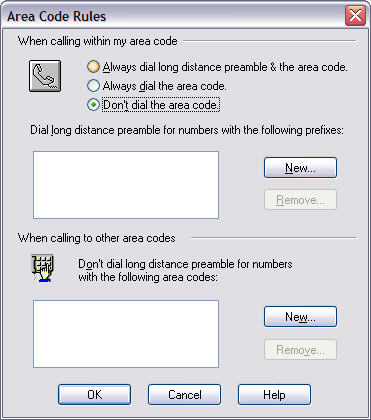

Set the rules for dialing Area codes in the US or Canada by clicking the Area Code Rules button at the bottom of the screen to bring up the Area Code Rules window.
When making local calls in some areas of the US and Canada, the phone company requires the area code or even the long distance preamble plus area code. To specify the requirements for your area, select one:
■ Always dial long distance preamble and area code.
■ Always dial long distance area code
■ Don’t dial the area code
In some cases, this requirement applies only when you are dialing specific exchanges. To specify when this is necessary, click the New button in the Dial long distance preambles with the following prefixes: area.
Likewise, when making long distance phone calls, you may not need to use area codes and long distance preambles for certain area codes. Click New to specify the areas codes that do not require the addition of area code numbers in the box for When calling to other area codes.
When you are finished with your selections, click OK to return to the Dialing Properties window. Click Apply dialing rules to fax numbers to activate the dialing rules you’ve just defined.
